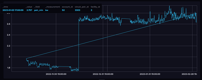

Two tables returned with identical group keys
Can anyone help me figure out this issue? I restructured my database, and have to fill in historical data into the new format. For some reason, the historical data comes out in a different table when I query it, even though all the values in the group key are identical. If I call group() using the same group key, they all end up in 1 table, but I don’t want to have to do that every time I query the database.
Here’s the flux that generates that result:
from(bucket: "power_circuit_lores")
  |> filter(fn: (r) => r["_measurement"] == "kw")
  |> filter(fn: (r) => r["_field"] == "pair_min")
  |> filter(fn: (r) => r["circuit_pair_id"] == "3303")
  |> yield(name: "mean")
Running on InfluxDB OSS 2.6.1
I tried calling distinct on each of my columns in the group key to see if there was some formatting difference between some of the values, but I get this error, presumably because there are two tables with the same group key values.
runtime error @8:6-8:30: unique: unique found duplicate table with key: {_field=pair_min,_measurement=kw,_start=2023-02-01T20:20:53.847502436Z,_stop=2023-03-03T20:20:53.847502436Z,account_id=52,circuit_pair_id=3303,facility_id=2}
Curiously, when graphing, I only get one color line in the graph, as if it’s a single series, (which of course it should be,) but it connects the beginning to the end in a loop.
EDIT: Not quite a full loop. It is a single line, but there is a break between the old and new data when I zoom in.
If I run group on the same group key, then sort, I now get just one table and the correct graph. I tried piping that query to the same bucket, to overwrite the existing data, but that didn’t help anything.
