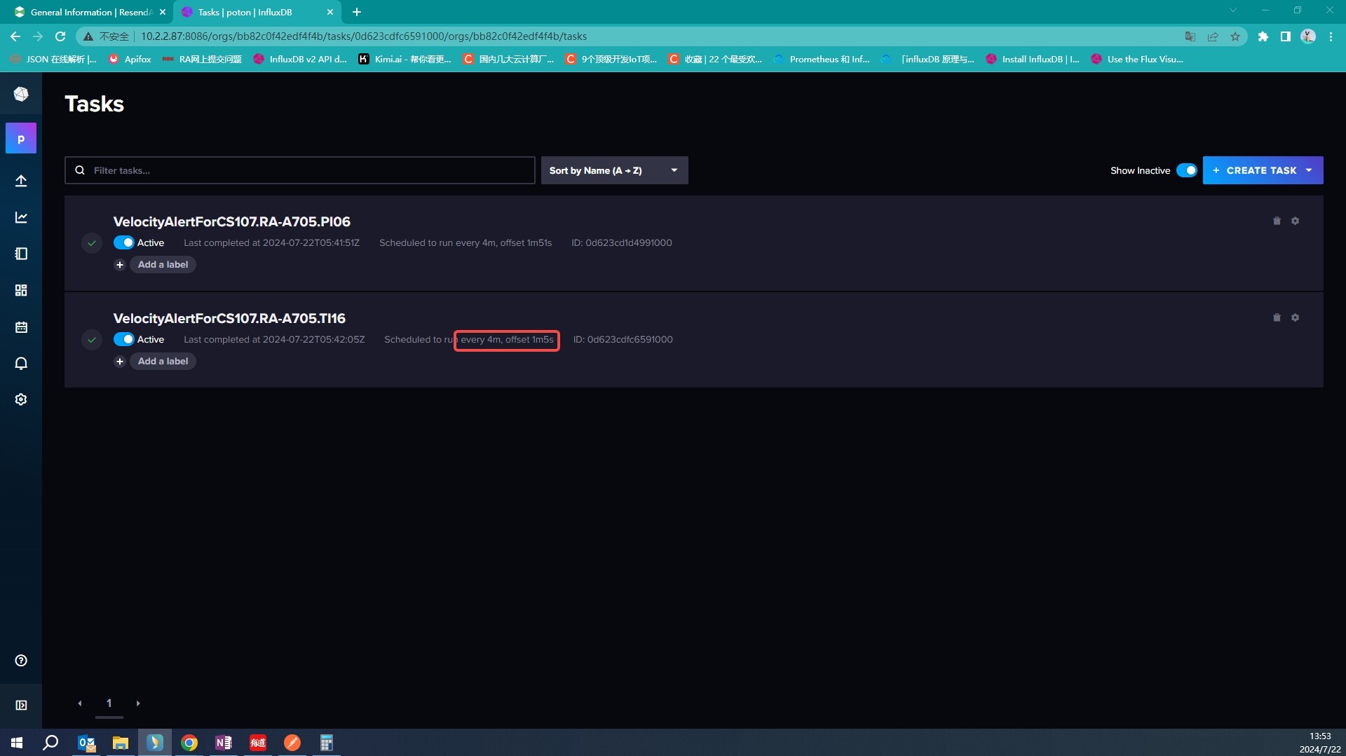

Task can not start from the rigth time
  1. When task was set to run every 4m, offset 25s at 2024-07-22 13:29:25, this task should run from 2024-07-22 13:33:25 in my mind.But this task started to run from 2024-07-22 13:32:25.
  2. So I tried to change the add 1m t offset param. task was set to run every 4m, offset 1m5s at 2024-07-22 13:42:05, then this task started to run at 2024-07-22 13:45:05 rather than 2024-07-22 13:46:05
How can the task start to run from the right timestamp?
