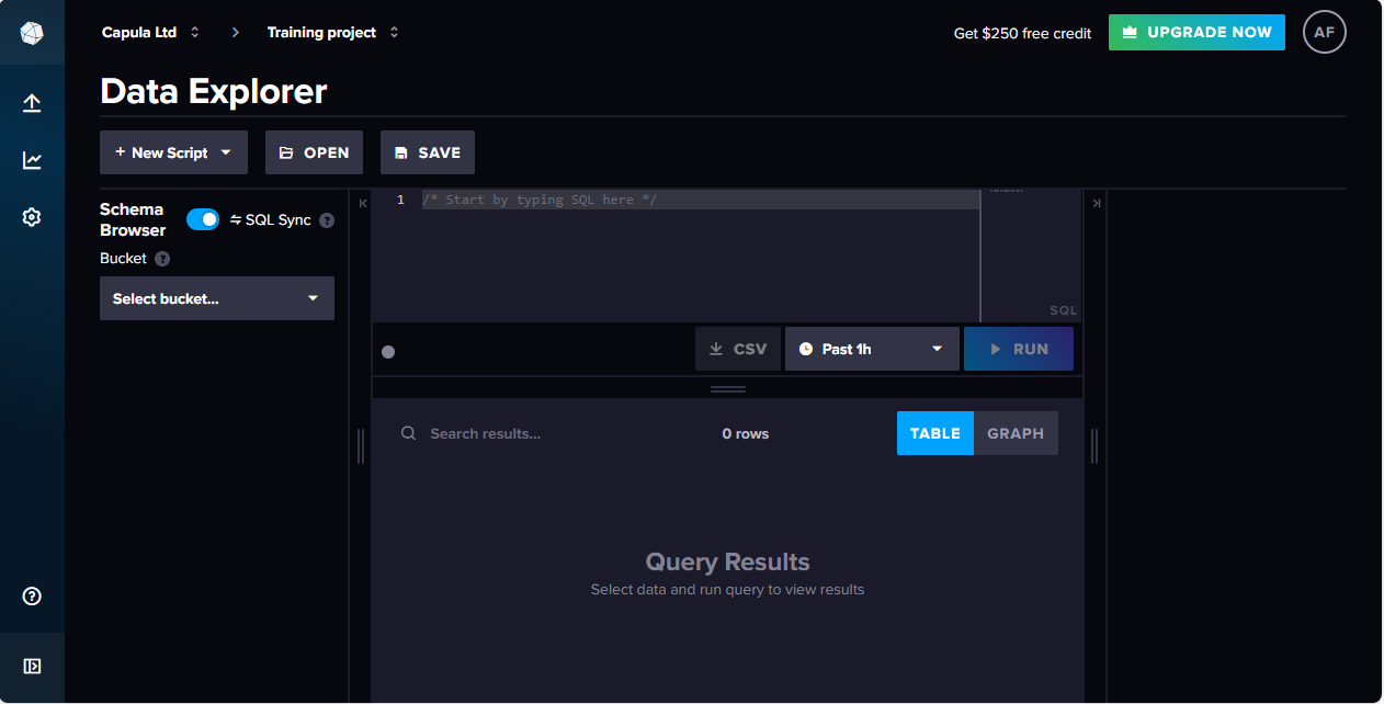

I’ve created an account in InfluxDB Cloud and logged into it. The instructions say to “click on the + Create Bucket button” in the Explorer page. But my explorer page looks quite different to the example screenshot and does not have a + Create Bucket button that I can see. Here’s my page:
I did try to do this course last year and I recall having issues back then as well so maybe something I did then has already borked my account for this course?
Can anybody tell me what I am doing wrong?
Oh, seems there are some parts of this course that needs an update, thanks for brining this up. In the meantime please follow this handy tutorial and if you have any questions, just ask here: Set up InfluxDB | Get started with InfluxDB | InfluxDB Cloud Serverless Documentation
