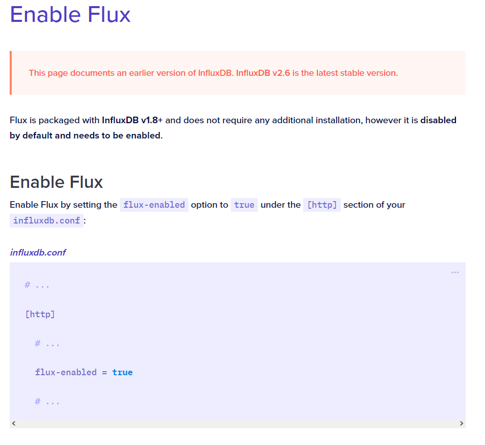

Pooh, This is what I am going by…I aam assuming that it still holds true.
https://docs.influxdata.com/influxdb/v1.8/flux/installation/
Ah, apologies, I wasn’t aware of that. However, I haven’t tried to use Flux
