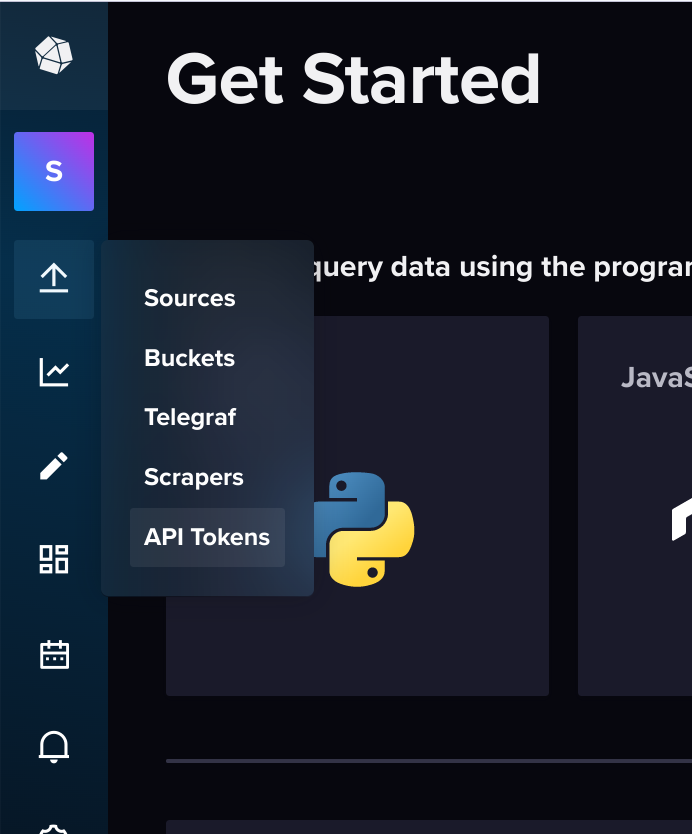

Can you see this? (at http://your-ip-address:8086/)
and then
Thanks, I can see that; but under the API Token tab, all I can see is the token’s name and permissions it has, not the token itself; and when I go back to terminal and use influx config command, I was asked to provide the token itself, which I can’t see if I set it up via UI.

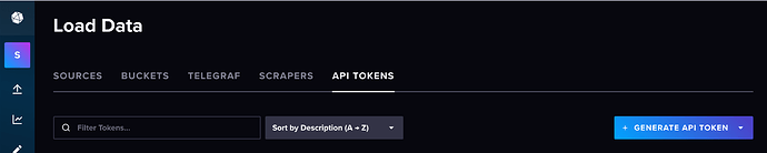

Can you click the Generate API Token and create an all-access token?
Yes, I am able to create all-access token from the UI and I can note down the token at the time of creation. It’s only when I setup my account the operator token doesn’t really show itself after creation like when we create an all-access token.
