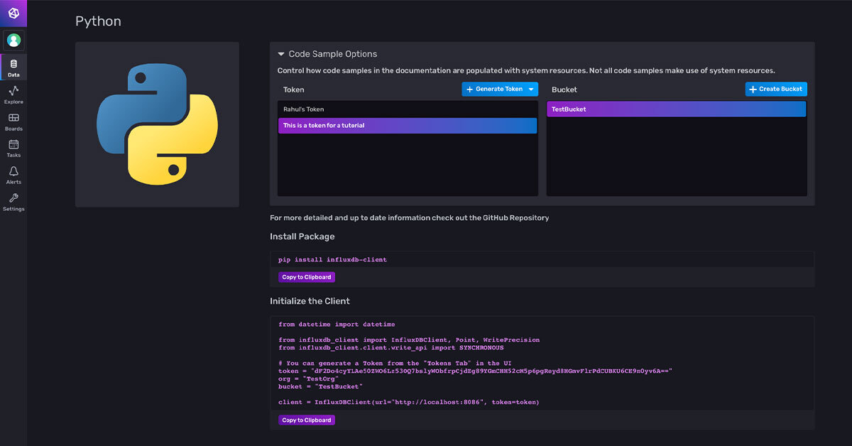

I’m trying to get access to the client libraries Python on my localhost:8086 Debian VM, but when I click on it, it shows me a page saying “404 : Page not Found”.
I have tried to figure out why, and the only reason that came to me is maybe I have the wrong version of python in my file, maybe.
PS : I already did pip install influxdb_client
Hello @Markus_M,
Yes the docker image doesn’t come with python. This portion of the UI is just a tutorial. You’ll have to include it in your docker compose and run your own python script.
Here’s a tutorial on how to use the python client library:
