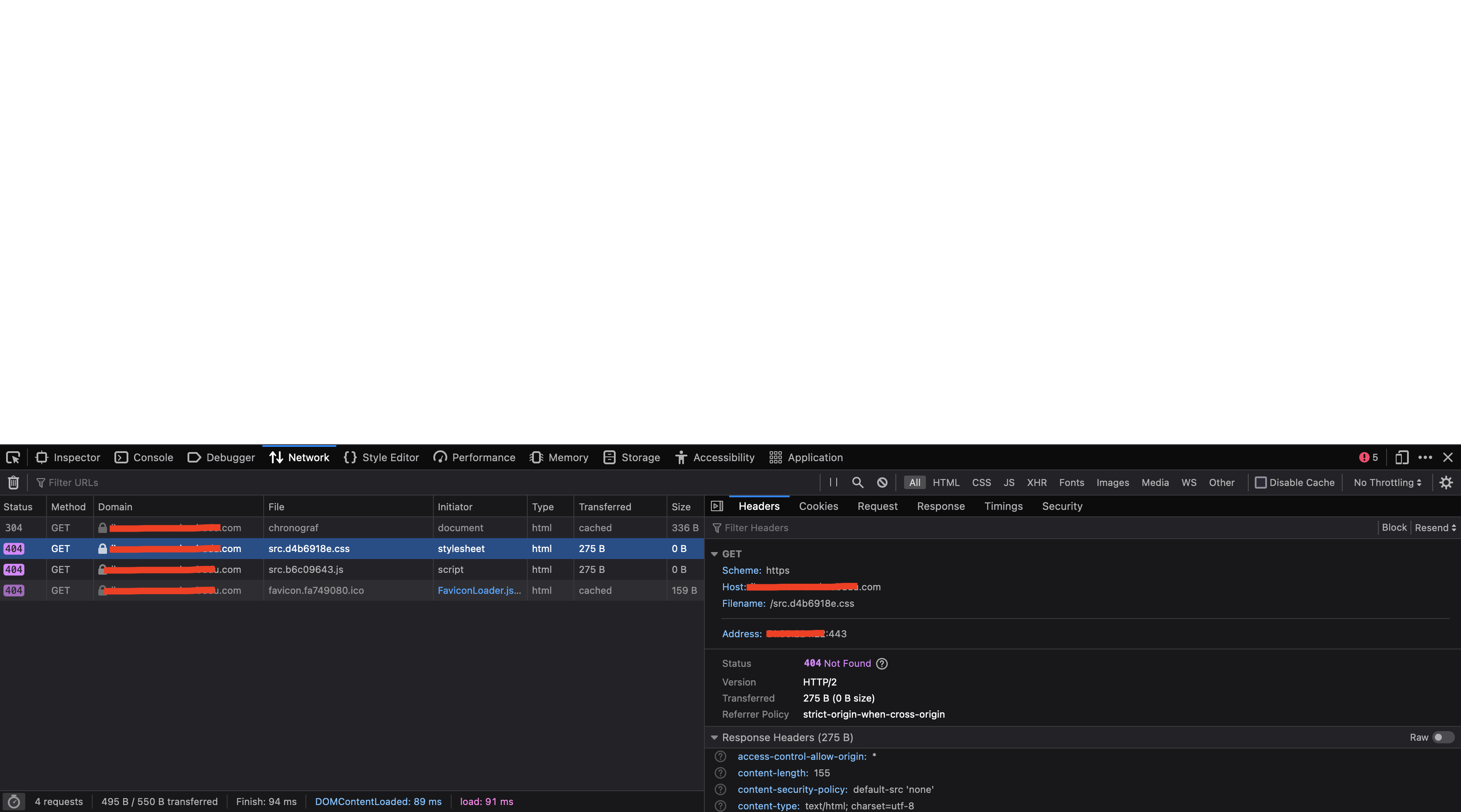

Chronograf opens in a web browser using address “https://mydomain.com/chronograf”
Actual behavior:
A blank page opens, see screenshot

When I empty the /etc/default/chronograf file and change rule to
"traefik.http.routers.chronograf-https.rule=Host(`{{base_url}}`)",
then page loads up properly when I try just the address https://mydomain.com without any paths, see screenshot
So this means my environment is good and it is just a matter of either Traefik tags being wrong for Chronograf or Chronograf docker container being misconfigured. What may I be doing wron
