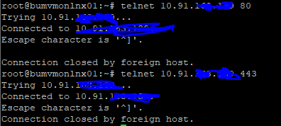

i dont have Proxy in the middle.
using telnet to test connectivity does not appear with problems
What do you advise me to continue trying and solve my problem?
