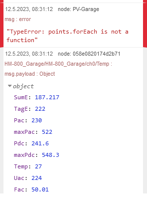

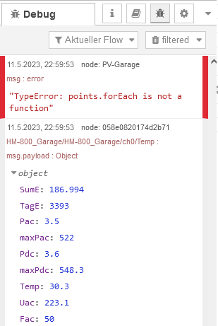

here I get the following error message:
5/11/2023, 17:59:45node: pv-garage.
msg : error
“TypeError: points.forEach is not a function”.
and this is the msg.load:
HM-800_Garage/HM-800_Garage/ch0/Temp : msg.payload : Object
object
SumE: 186,842
TagE: 3241
Pac: 158.8
maxPac: 522
Pdc: 166.8
maxPdc: 548.3
Temp: 36.6
Uac: 225.5
Fac: 50.01
