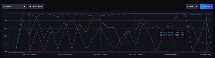

Without “last()” I get good data (see screenshot)
