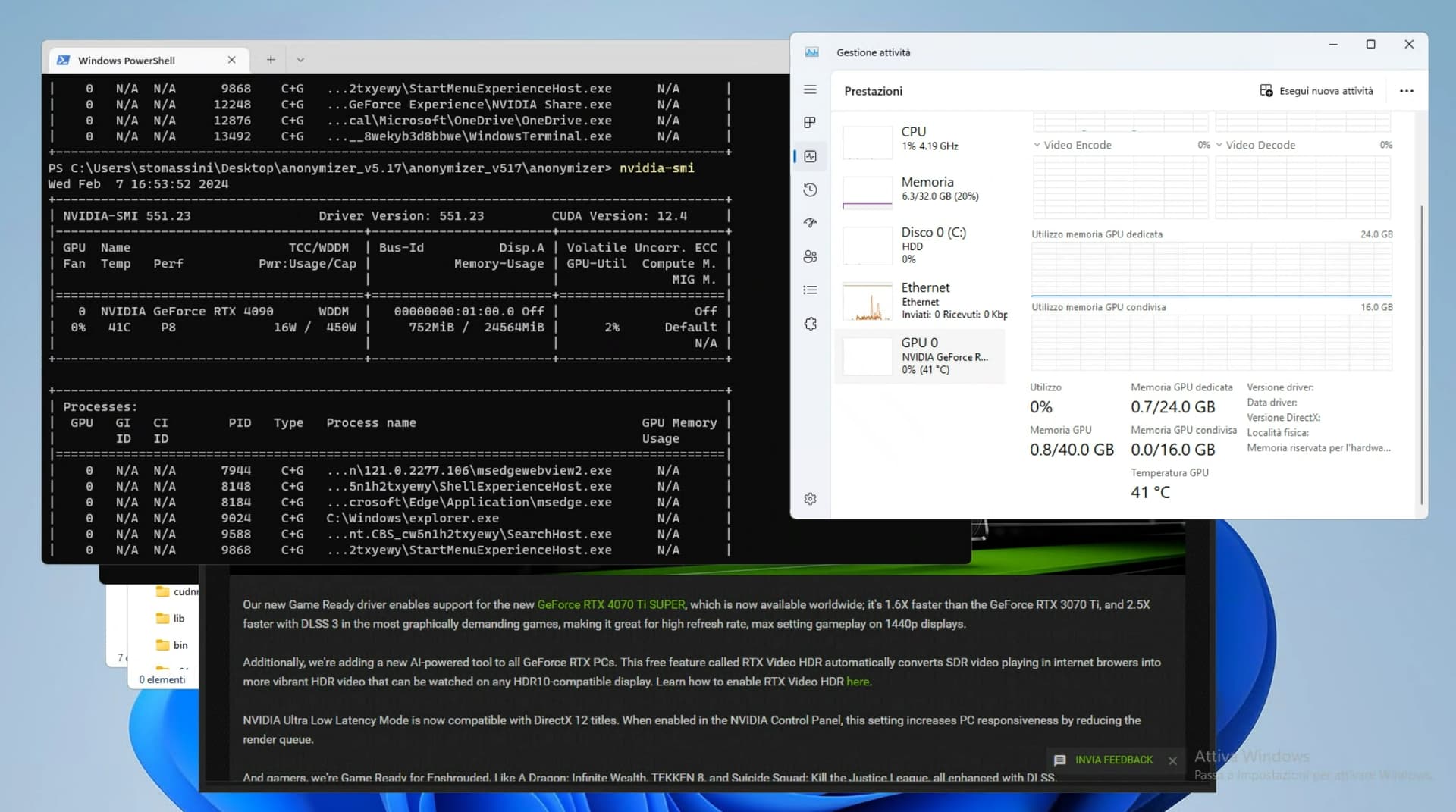

Influx doesn't work as a service in Windows 11
Suddenly, without anything having changed and in another twin system still working, telegraf no longer sends data if started as a service.
While if started from cmd it works without problems.
I tried activating the logs but there are no errors.
No problems are reported from the Windows event viewer either.
The problem does not occur if I deactivate the “inputs.nvidia_smi” plugin.

[[inputs.nvidia_smi]]
How do I enable debug mode?
What do you mean with platform?
I’am running on Windows 11.
Are you sure that system has the nvidia-smi binary?
Your TOML looks valid. If you run telegraf via the CLI with that config does it work?
Add --debug to the CLI or add under the [agent] section debug = true

Yes. If I make changes to the plugins to be integrated they are executed.
What I put in previous posts.
If I run telegraf from CLI, it works.
It doesn’t work as a service.
