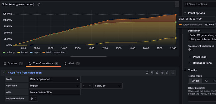

I found another way to do this, in Grafana, which allows me to view the total energy over any time period that I want.
By calculating the difference and then the cumulative sum of the meter (cumulative) field, it always starts at zero on the left edge. So I can view the last 24 hours, today, the last 4 hours, the last week, the whole of 2024, any period at all that I want in Grafana, and the right hand edge gives me the total energy over that period (and everywhere in between is all energy since the start of the period).
Then, to calculate the consumption (import + generation) I use an “Add field from calculation” transform in Grafana, in this case a Binary Addition Operation:
