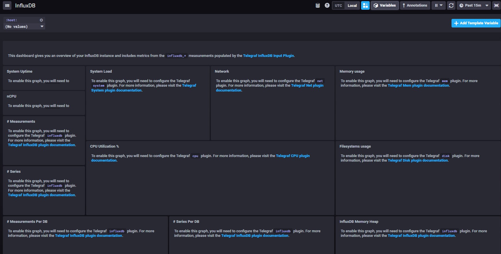

In the Chronograf end we found two templates called “influxdb” and “system”. Only the second one works fine. Isn’t there a template that matches the influxdb2 parameters?
In the attachment you can find an example screen of the Influxdb template which is not working.
