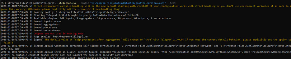

We’ve trying to load the data from kepware to store the data in influxdb using telegraf agent connectivity. While configuring the telegraf agent using “telegraf.conf” file we were ended with few errors. The “telegraf.conf” file which includes the details of both Kepware configuration, Machine data and the Influx DB.
Attaching the telegraf config file herewith.
As a part of setup, I generated the telegraf certificate .
We’ve ended with error after trying to connect the security mode and security policy as similar from the screenshot.
Thanks & regards,
Shaik
We’ve ended with below error after trying to connect the security mode and security policy as similar to
[Upload failed]
Kepware opcua configuration below.
Kindly suggest to skip the certificate error while configuring the telegraf.conf file.
