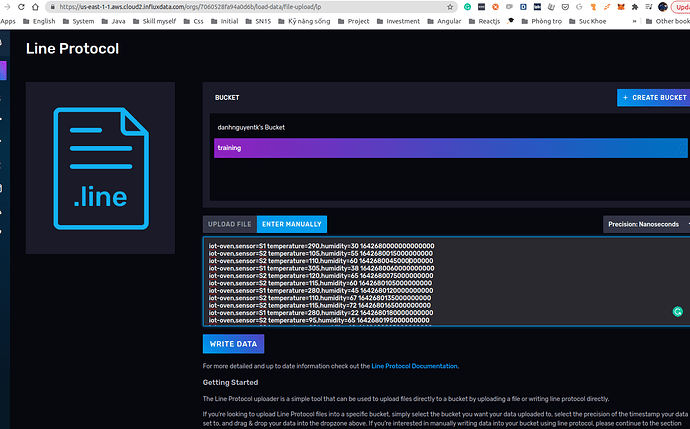

I input data manually and notify success, but when I query, not any data showed.
Please help me.
I input manually by below lines:
Where/How do you query?
Is the time window chosen correctly? Otherwise you will not see any data.
You are right, Not show data because time range for query, thanks thanks
The reason why you don’t see any data is that the time window is wrong. On the right side of the window you selected “Past 2d”, but your data is older when I look at the timestamp?
Unfortunately, if the time window is not selected correctly, no data is displayed, which is quite irritating for beginners.
Yes, because I copy sample data from exercise with time format nanosecond (dont know exactly date) and forget this problem is here.
Thanks so muck guys.
