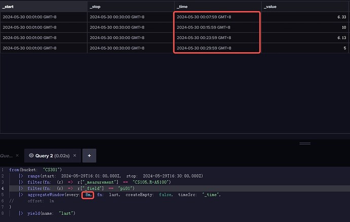

Puzzled time with aggregateWindow() function
a topic linked to github
when query code is:
from(bucket: "CS301")
  |> range(start: 2024-05-29T16:01:00.000Z, stop: 2024-05-29T16:30:00.000Z)
  |> filter(fn: (r) => r["_measurement"] == "CS105.R-A5100")
  |> filter(fn: (r) => r["_field"] == "pi01")
  |> aggregateWindow(every: 7m, fn: last, createEmpty: false, timeSrc: "_time",
//   offset: 1m
  |> yield(name: "last")
1.data retrieved as bellow when every is setted to 7m
  1. data retrieved as bellow when every is setted to 8m
when query code is:
    |> window(every: 7m, createEmpty: true)
    |> unique(column: "_start")
data retrieved as below:
