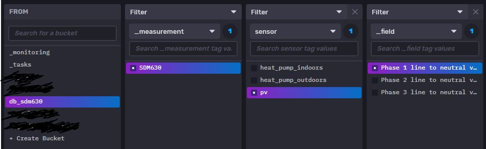

I still have something where I make a mistake and don’t know how to solve it.
I was able to get the e.g. [[inputs.cpu]] and [[inputs.disk]] template running in telegraf.conf. But when i try to add another .conf file, to receive data stream from somthing else onto a specific bucket, one of the buckets gets populated with the Measurements from the wrong output.
What I don’t understand is why is data from “[[outputs.influxdb_v2]]” from sdm630.conf ending up in bucket “db_home” and “db_sdm630” and why is the data from [[outputs.influxdb_v2]] solaredge_modbus.conf only added in bucket = “db_solaredge”?
I would like to get the data from the different configs in the associated buckets.
It would be great if someone could help me. Below my configs.
