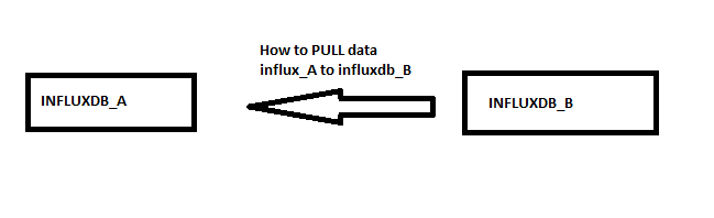

How to pull data from influxdb_A to influxdb_B?
INFLUXDB_B pull data from INFLUXDB_B ???

SUBSCRIPTION its push, whereas I want pull db
