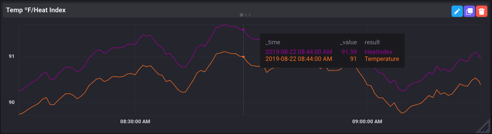

But in the end, you can then have a graph that shows the actual temperature and the calculated Heat Index in the same table cell:
And that’s a pretty cool thing!
