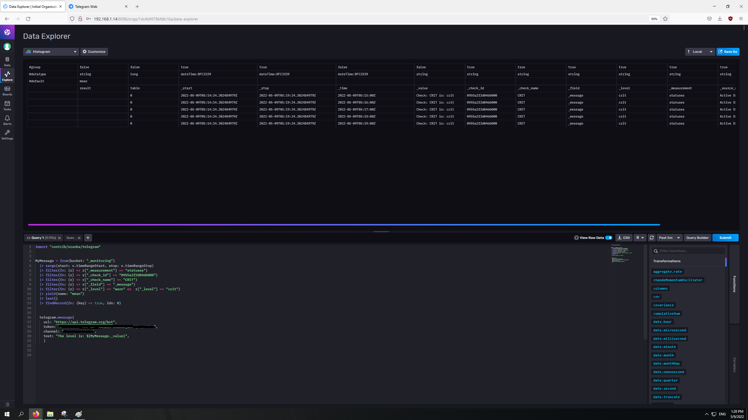

I am currently trying to Make this script a Task, using this script that acts as an alert, i would send an Notification to telegram. But however, it only sends the notification when i click submit or hover back and forth from one query to another. i followed this Link to create this script.
Also while saving this script as a Task, i encountered this issue, if anyone knows what is going on or what am i doing wrong please feel free to comment. Much Help Appreciated!!

Hello @Anaisdg,
Thanks for the Suggestions, for the first step that you gave i have already done it which shown in the picture below. I get another error but now the error is different.
For the second step which u suggest array, can you guide me on that because I’m not very clear on that step and not familiar with that function. Is it possible to tell me where to add my array or so. That would be great help.
