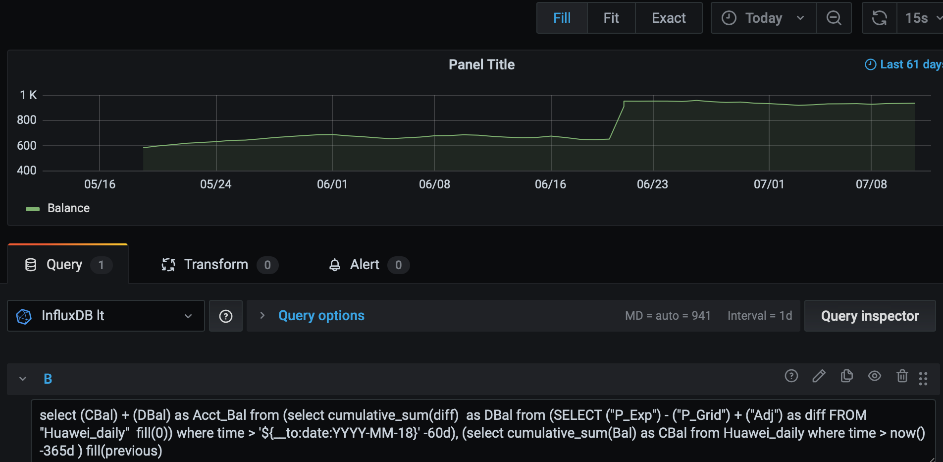

Display since the last data point
Trying to limit the displayed data from the last data point of one of the series. There are only some point in Bal, which are stored once every x months. Adj can be stored sporadically.
The other series P_Exp and P_Grid are stored daily. The graph shows a disconnect in the data points with a step, but this is due to Bal having a value there.
Could I limit the displayed curved from that point onwards?
If the fill(0) isn’t there, I only see the Bal data point. Without the fill(prevous), nothing is displayed
select (CBal) + (DBal) as Acct_Bal from
(select cumulative_sum(diff)  as DBal from
        (SELECT ("P_Exp") - ("P_Grid") + ("Adj") as diff FROM "Huawei_daily"  fill(0)) where time > now() -60d),
(select cumulative_sum(Bal) as CBal from Huawei_daily where time > now() -365d) fill(previous)

@Anaisdg, Hi
You can see a step discontinuity in the graph (around 6/21). This is because there is a value for Bal, which there isn’t at any other point (the previous was 2 months before).
I would like to only show the data from that point forward, since the billing period starts on that day. I want to only have the data from the 21st onwards. Though the calculated values are correct, so even if it is showing a shorter period, it should still consider the entire span.
Basically, it is to only show the graph as shown, but from 6/21. This date is determined by the last stored value for Bal. So for future dates, it would start from wherever the last Bal was at. Still needs to find the cumulative sum for the last year of Bal

select * from (SELECT (“P_Exp”) - (“P_Grid”) + (“Adj”) as diff FROM “Huawei_daily” where time > ‘${__to:date:YYYY-MM-18}’ -60d), (select last(Bal) from Huawei_daily) fill(previous)

Let me know if my trying to clear things above helped? I don’t want any data older than the last value of Bal. In the first image above, it would only show the data after the step discontinuity (around the 6/21).
The reason is there is a rolling window that is the billing cycle, and once the date passes, I don’t need to display the older data from the previous bill
