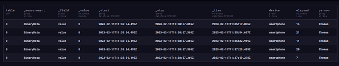

gives us an additional column called elapsed that shows the number of seconds from each consecutive record:
Next, add a filter statement after the elapsed function to filter out only those whose _value = 0. This is because the “active” time (when the state 1 goes to state 0) is captured in those records where _value = 0. If you wanted to know the time when the phone is NOT active, you would set the filter where _value = 1.
