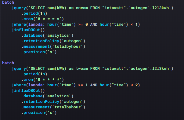

Thanks! Looking forward to v2. For now it looks like I managed via tickscripts and grafana on the visual side:
Not optimal, but will do while we wait for something better.
