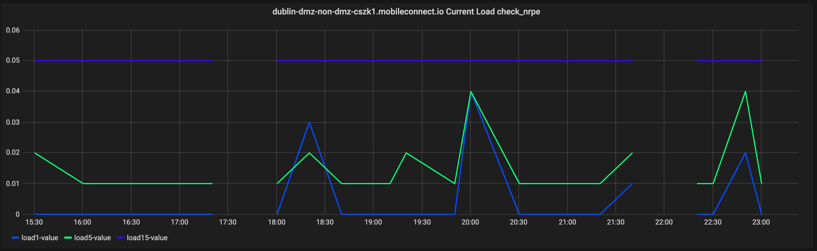

I am referring to https://support.nagios.com/kb/article/nagios-core-performance-graphs-using-influxdb-nagflux-grafana-histou-802.html. I am running influxdb 1.7.9 on CentOS Linux release 7.7.1908 (Core) . I am seeing the breaks as per the grafana chart.
I have got this response from Nagios Forum.
The breaks in performance data generally mean you are not receiving valid data back from the plugin during these intervals, or perhaps for some reason, the performance data is being deleted before it is being processed. You may want to look at the influxdb logs to see if it is reporting any errors.
Versions :- influxdb-1.7.9-1.x86_64 , grafana-6.5.3-1.x86_64, histou v0.4.3, Nagflux v0.4.1, CentOS Linux release 7.7.1908 (Core), Nagios Core 4.4.5
Please let me know if you need any additional information.
grafanaimage

Also, what do you mean by “breaks” in the data?
  • periods of time without data?
  • particular chars (ie: spaces) inside some of the values?
@Giovanni_Luisotto
A sample of the data, with the current and desired output. Is there any SQL query to query influx DB? Any example regarding SQL query for timestamp?
Yes, there is no data for specific periods of time. I am referring to Nagios Core - Performance Graphs Using InfluxDB + Nagflux + Grafana + Histou. I look forward to hearing from you. Thanks in advance.

@Giovanni_Luisotto I am attaching the screenshot for your reference. For example is there a way to run sql query in InfluxDB for the time period between 17:20 till 18:00 where there is no data?
You can use “fill(previous)” instead of “fill(null)”, which is the default one.
This will show the previous value if there are no points in the current range

  • Can you run a query to get data that do not exist? no
  • Can you “emulate” data that do not exists? yes
At the end of your current query, whatever it is, you can add a function, called fill()
Docs here
# example
# This will replace nulls with the last available value
SELECT {...} FROM {...} WHERE {...} GROUP BY {...} fill(previous)
In your case, you may want to use previous or linear as the fill parameter
@Giovanni_Luisotto It works fine when I use fill(previous). I am not sure where do I set it permanently?

I’m not going to read that article, but since you are using grafana you will have to edit the query inside the chart and add the fill function.
Sample:
@Giovanni_Luisotto I got it working by referring to the docs. The issue is that Histou which is a Grafana add-on that creates graphs specifically for the Nagios performance data generates dashboards without that behavior. Can it be done using histou? More Info regarding histou:- GitHub - Griesbacher/histou: Adds templates to Grafana in combination with nagflux. I look forward to hearing from you.
