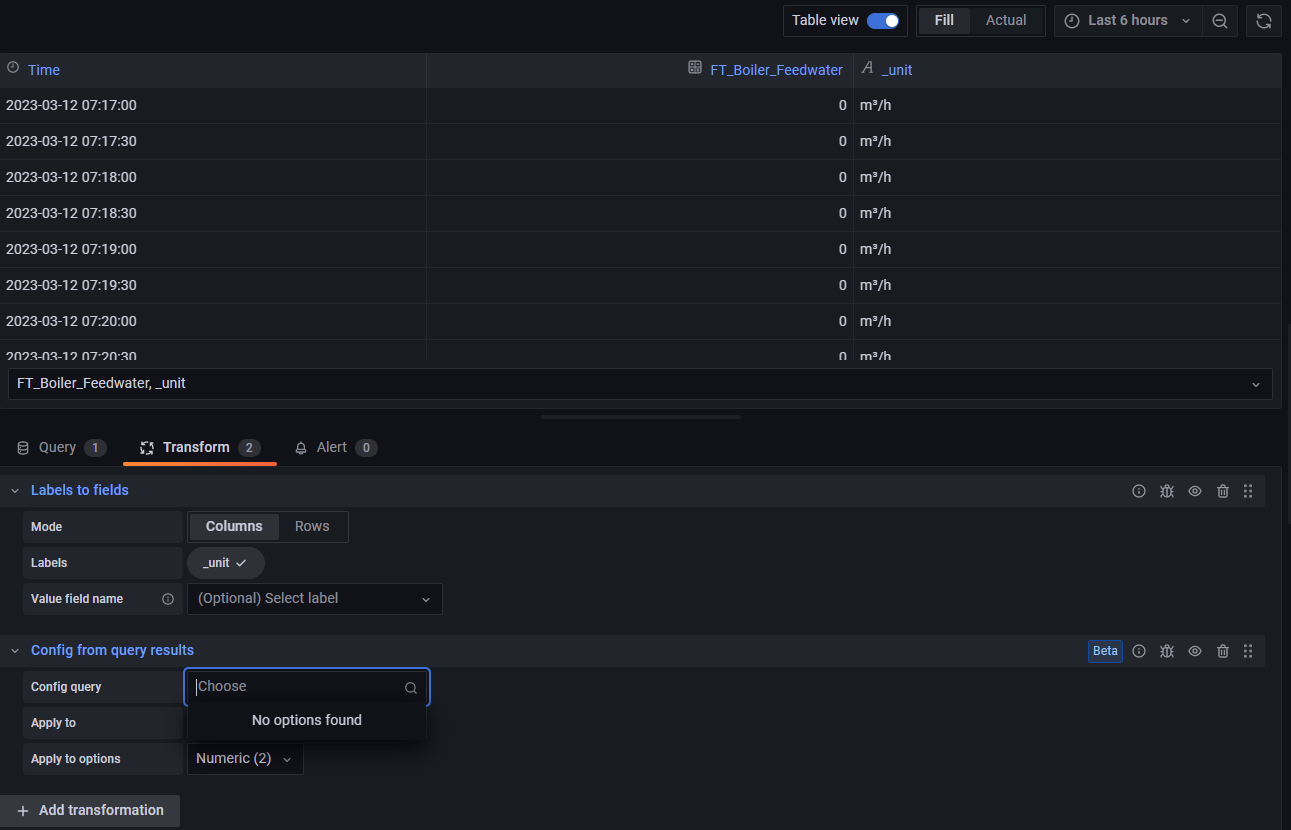

Must say I was a bit optimistic. While the combination of the 2 transformations should do the job, the “config from query results” is still in Beta and does not seem use the output of the first transformation.
When I disable the “labels as fields” transformation you can see where this config would become usefull.
It shows all the fields and you are able to select a column and set it as the unit.
I also tried testing with returning multiple fields, but this makes it even more confusing.
Seems like the config from query result has to be configured for each of the returned fields, which all have the same query name.
