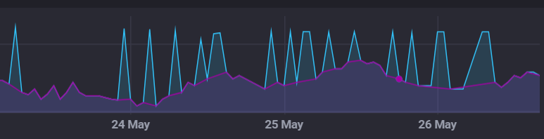

When I use the query with FILL(none), it works fine, but then I can encounter gaps at the beginning or the end of the graph which I’d like to avoid with FILL(previous).
Below is the graph made by two CQs which only differ in FILL(…) clause:
This is the CQ data with the peak example:
select mean_value from a_year.downsampled_temp where time >= '2019-05-23 04:00:00' and time < '2019-05-23 09:00:00' and entity_id = 'temp1' tz('Europe/Moscow')
time mean_value
2019-05-23T04:00:00 9.5
2019-05-23T05:00:00 8.5
2019-05-23T06:00:00 25.3 <<--- the peak
2019-05-23T07:00:00 6
2019-05-23T08:00:00 5.333333333333333
