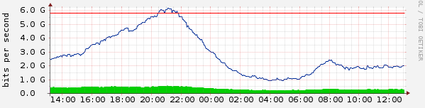

Hello! I am attempting to draw a straight line in Grafana like in rrd (in this case the maximum, not 95th percentile):

In order to get Grafana to draw the line I believe I need a result that has the same maximum value on each timestamp. Is this possible?
time bps max
2019-07-31T04:50:40.612Z 4186760242.165622 10753011808
2019-07-31T04:51:10.614Z 4182186443.037131 10753011808
2019-07-31T04:51:40.616Z 4324680719.9520035 10753011808
[etc]
