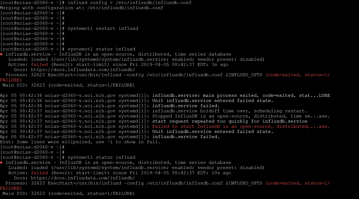

but now when I type influxd I see this and it is just loading:
that’s a good sign :slight_smile:
When it stops scrolling , you can press control c to cancel
and then try with systemctl start influxd
I have done the systemctl start influxd and still the service doesn’t start another troubleshooting command to run?
yes these can give some more information
journalctl -u influxdb
ls -al /etc/influxdb/influxdb.conf
[root@ncias-d2060-v ~]#
[root@ncias-d2060-v ~]# ls -al /etc/influxdb/influxdb.conf
-rw-r–r--. 1 root root 3371 Apr 5 08:42 /etc/influxdb/influxdb.conf
