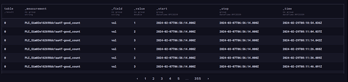

Screenshot of data:

Your schema’s have to be the same as the error indicates.
I would try adding:
Before the group()
Also these could be helpful:
InfluxDB returns data sorted by time when you just perform from range filter :slight_smile:
