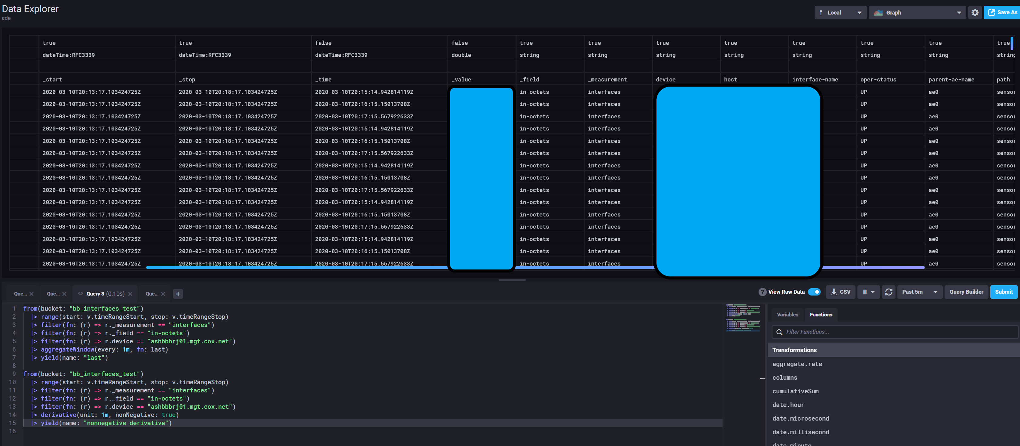

I’m currently collecting telemetry stats from my router. I need to convert octets to BPS. I do this by using the non-negative-derivative function. Then I need to divide by 60 and multiply by 8 to get BPS per minute. I’m able to generate the final output but would like to have it displayed as a separate column with the rest of the data like “interface-name”, “device”, “host”, etc.
This is my query before I divide by 60 * 8:

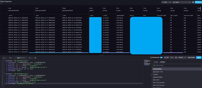

When I divide by 60 * 8 I get this:
