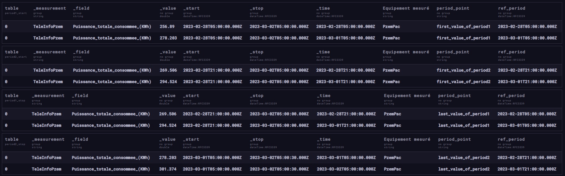

That’s it, I was able to advance to the “intermediate” stage.
Now I have 4 correct tables:
Table01 => counter at start of the period1 (at 05:00Z of each day)
Table02 => counter at stop of the period1 (at 21:00Z of each day)
Table03 => counter at start of the period2 (at 21:00Z of each day)
Table04 => counter at stop of the period2 (at 05:00Z of each day)
As I couldn’t get what I wanted with the function ‘hourSelection()’, I came back to the function ‘aggregateWindow()’ with an offset value to have exactly the 2 periods per day I was looking for.
The query:
import "math"
Range_start = 2023-02-28T05:00:00Z
Range_stop = 2023-03-02T05:00:00Z
//start1 = Range_start
start2 = time(v: uint(v: Range_start) + uint(v:16h))
//stop1 = start2
stop2 = time(v: uint(v: Range_start) + uint(v:24h))

Period1Start = from(bucket: "Energie")
  |> range(start: Range_start, stop: Range_stop)
  |> filter(fn: (r) => r["_measurement"] == "TeleInfoPzem")
  |> filter(fn: (r) => r["Equipement mesuré"] == "PzemPac")
  |> filter(fn: (r) => r["_field"] == "Puissance_totale_consommee_(KWh)")
  |> aggregateWindow(every: 24h, offset: 5h, timeSrc: "_start", fn: first)
  |> set(key: "period_point", value: "first_value_of_period1")
  |> map(fn: (r) => ({r with ref_period: date.add(d: 0h, to:r._time)}))
  |> yield(name: "period1_start")
Period2Start = from(bucket: "Energie")
  |> range(start: start2, stop: Range_stop)
  |> aggregateWindow(every: 24h, offset: 21h, timeSrc: "_start", fn: first)
  |> set(key: "period_point", value: "first_value_of_period2")
  |> yield(name: "period2_start")
Period1Stop = from(bucket: "Energie")
  |> set(key: "period_point", value: "last_value_of_period1")
  |> map(fn: (r) => ({r with ref_period: date.sub(d: 16h, from:r._time)}))
  |> yield(name: "period1_stop")
Period2Stop = from(bucket: "Energie")
  |> range(start: stop2, stop: time(v: uint(v: Range_stop) + uint(v:30s)))
  |> set(key: "period_point", value: "last_value_of_period2")
  |> map(fn: (r) => ({r with ref_period: date.sub(d: 8h, from:r._time)}))
  |> yield(name: "period2_stop")
The result:
At this point everything seems fine to me.
By adding:
union(tables: [Period1Start, Period1Stop, Period2Start, Period2Stop])
The result:
Always good to me.
Now with:
  |> pivot(rowKey:["ref_period"], columnKey: ["period_point"], valueColumn: "_value")
The result:
It’s not like hoping. I thought I had (before calculation)
The more I learn, the more I realize my shortcomings. :face_with_diagonal_mouth:

@grant1
Sorry, I didn’t show the result of your proposition on my query of 04/03/23 03:48am.
So when I add your proposition:
  |> pivot(rowKey:["_time"], columnKey: ["newValue"], valueColumn: "_value")
The result was:
As I explained (in my mind), the function pivot() was enable to collect a unique value per period (with RowKey:["_time"]) to align values of “first_value_of_period1” and "last_value_of_period1 in a row, then “first_value_of_period2” and “last_value_of_period2” in an other row.
It’s the other side of the coin to have right counters at the beginning and at the end of my 2 periods of the day (05:00Z to 21:00Z and 21:00Z to 05:00Z) with my settings on function aggregateWindows() (I voluntarily played with “fn: first” for Period1Stop and Period2Stop to do that).
So ( as I have have right counters), I just added a “ref_period” column in my query of 04/03/23 06:17pm to set an unique time value per period (for good behavior of the futur function pivot() with RowKey:["ref_period"]).
Unfortunately with:
The result is (as I said yesterday):
