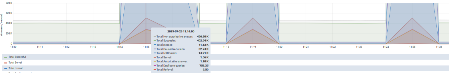

In Grafana :
When I try to use agreagation with sum fonction, Grafana I have a big problem. For exemple summon (agregregate) data of the first screen with the next one. The sum of this agregation return very huge and inconsistent value at the time I have not timestamp in my database.
I try to agregate data of all of my server with the query below :
Query : SELECT **non_negative_derivative** ( **sum** ("QrySuccess"), 1s) FROM "bind" WHERE ("host" = ~/^$host$/) AND $timeFilter GROUP BY time(1m) **fill** (0)
I try to fill with null value but this doesn’t work. How I can solve this issue ?
