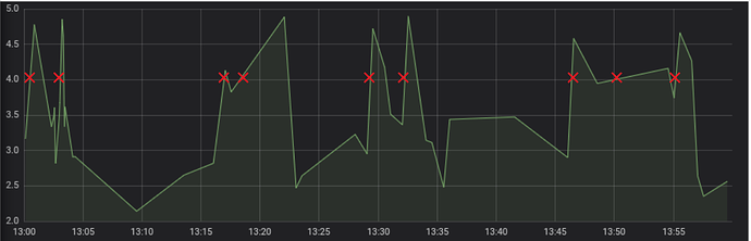

I have a simple series of power output, my query is very simple:
select power from head_unit
My requirement is to get all the first point’s where power > 4. Below graph will explain the issue:
I need all the points where there is a red cross.
I cannot check power = 4 as it will give me points on the opposite side of the curve as well.
Is it possible to get this value using query/subquery/flux?
Best,
Bhoomi

You can shift the values forward with timeShift, perform a join and filter for the instances where the next value is increasing like so:
data = from(bucket: "noaa")
  |> filter(fn: (r) => r["_measurement"] == "average_temperature")
  |> filter(fn: (r) => r["_field"] == "degrees")
  |> filter(fn: (r) => r["location"] == "coyote_creek")
  |> aggregateWindow(every: 6h, fn: mean, createEmpty: false)
//   |> yield(name: "original")
dataShift = data
  |> timeShift(duration: 6h, columns: ["_time"])
//    |> yield(name: "timeshift")
joined = join(tables: {data:data, dataShift: dataShift}, on: ["_time", "_field", "_start", "_stop", "_measurement", "location"], method: "inner")
  |> filter(fn: (r) => r._value_data == 80.0 and r._value_dataShift > r._value_data)
  |> yield(name: "joined and first instances of data")
